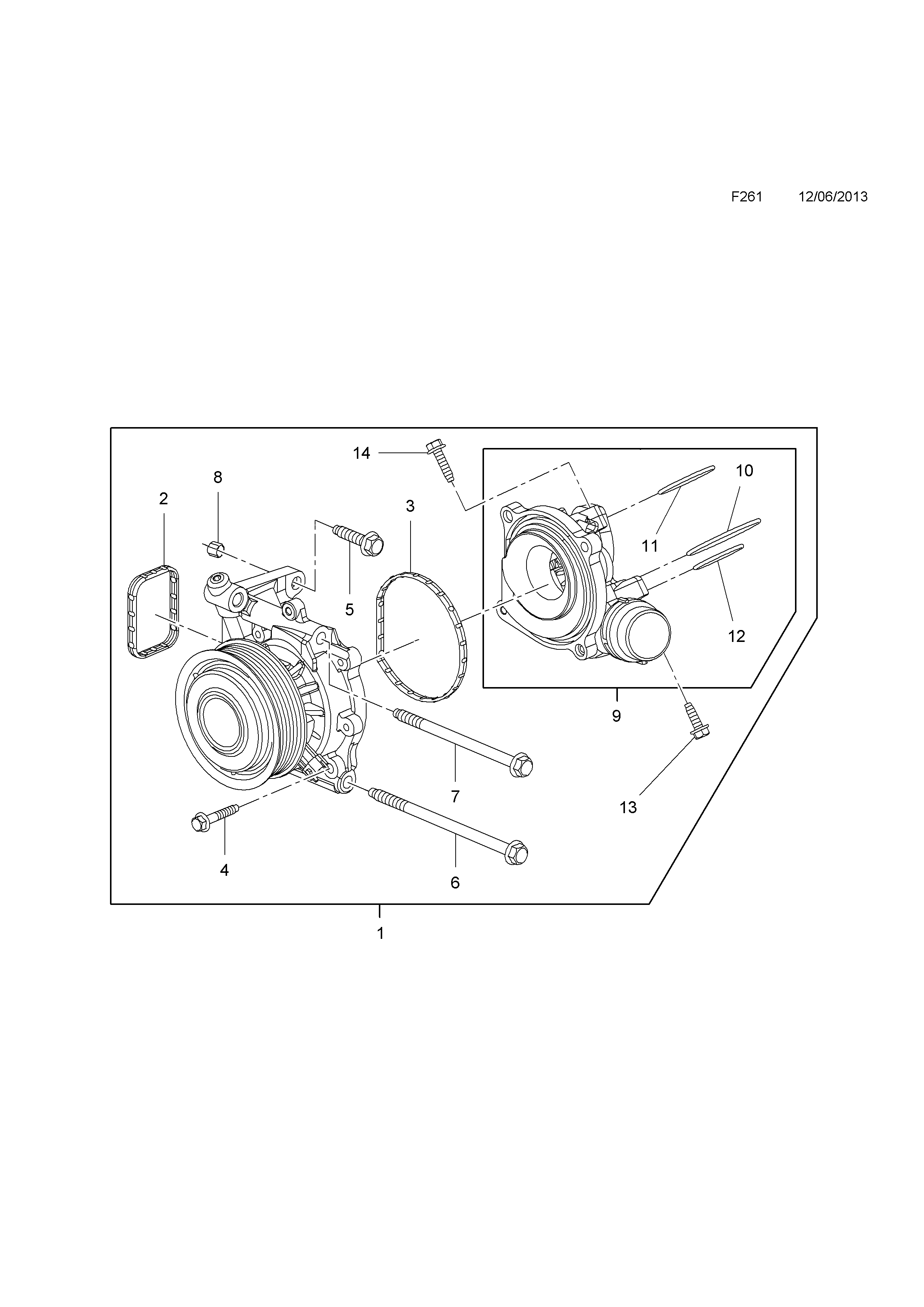

№NameExt. inf.A*Part numberGM numberA
B16DTH[LVL],B16DTJ[LVL] DIESEL ENGINES[/c]
9
-thermostat, assy.
9
-thermostat, assy.
10
--'o'ring, 53. 0mm id
11
--'o'ring, 35 mm id.
12
--'o'ring, 40mm id.
13
-screw, hex. hd., m6 x 20
2
14
-screw, hex. hd., m6 x 25
2
